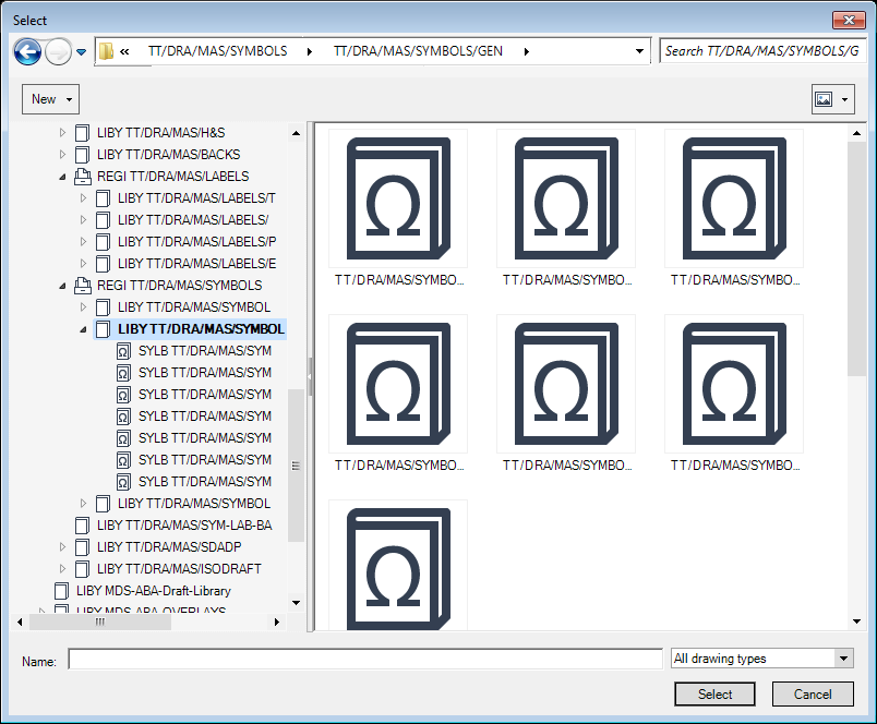

To add symbols to a drawing, on the Annotate tab, in the Insert group, click Symbol to display the Select window.
The Select window can be used to select the required SYTM or ISOTM element.
Double-click the required element, or click the element and click Select. The symbol is used as the default symbol for the session until another symbol is selected.
