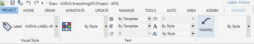

Allows the user to select a visual style for the label. Refer to Create and Modify Visual Styles for further information.
Select Left from the drop-down list to left justify the label text.
Select Right from the drop-down list to right justify the label text.
Select Centre from the drop-down list to centre justify the label text.
Select Base from the drop-down list to align the label text with the base of the first character (on the first line of text).
Select BBody from the drop-down list to align the table text with the bottom of the body.
Select HBody from the drop-down list to align the label text halfway up the body.
Select TBody from the drop-down list to align he label text with the top of the body.

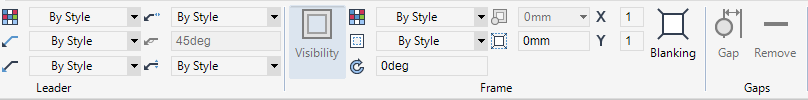

Input a value in the Label Leader Line Angle Value field to define the angle for the label leader line.
Allows the user to define the size of the terminator symbol if a Leader Line Terminator has been selected.
Input a value in the Label Frame Rotation Angle field to define the rotation angle of the label frame.
Allows the user to add gaps in leader lines. Refer to Leader Line Gaps for further information.
Allows the user to remove gaps from leader lines. The user is prompted to Select design element.
