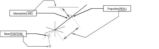

Returns TRUE if where lies on the unbounded line.
Returns TRUE if where lies on the line, bounded indicates if the point is also checked to be on the bounded line segment.
Returns TRUE if where, when projected onto the line, lies within the bounded line.
Returns the intersection line of plane on the line definition.
Returns the intersection points of arc on the line definition.
Returns the position at proportion along the “bounded” line from the StartPosition.

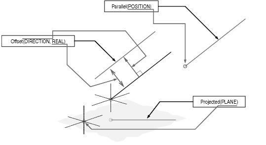

Returns a parallel to the line definition of the line object, through position. All other members are copied. See picture.
Returns a parallel line to the LINE object, offset by offset from the original in the given direction. See picture.
Returns the overlapping line of two parallel lines. All positions are return projected onto the original object. See picture.
