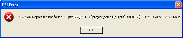

With the Output/Input tab highlighted, select Convert Stress Data. If this is successful a new XML file (StressGroupNameRet.XML) will be created and saved to the Return folder which is located at the same place as the input and output folders.
A HTML log (*_RetLog.html) is created and stored in the logs folder every time the Convert Output button is selected. The log gives more detail on what the conversion process has found and where, if any, problems have occurred. Any Errors will be highlighted in Red, Warnings in Blue and Restraints in green.
