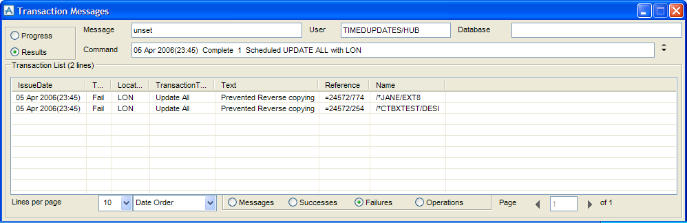

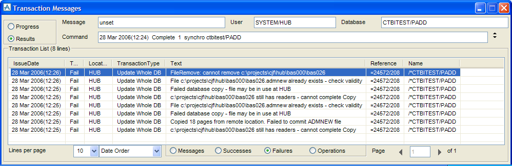

Generally a scheduled update will always succeed with a number of database failures
Failure messages will contain detailed reasons:
In this case, the databases could not be propagated, since the secondary database had a higher compaction number than the primary database. This may happen when a remote merge is executed without stopping scheduled updates. Normally it will be necessary to recover the database to resolve this error.
Prevention of Reverse propagation may also be reported in the following situation ‑ a satellite has executed a direct update (UPDATE DIRECT from the command-line) with a non-neighbour satellite. The next scheduled update with the intermediate location will report ‘Prevented reverse propagation’. In this case, scheduled updates will eventually resolve the situation.
