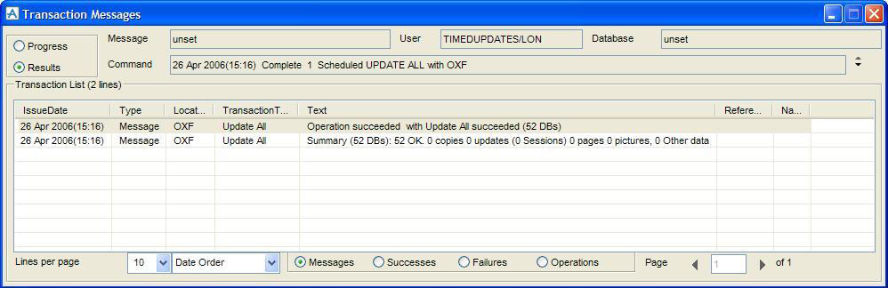

A successful scheduled update will normally report two messages:

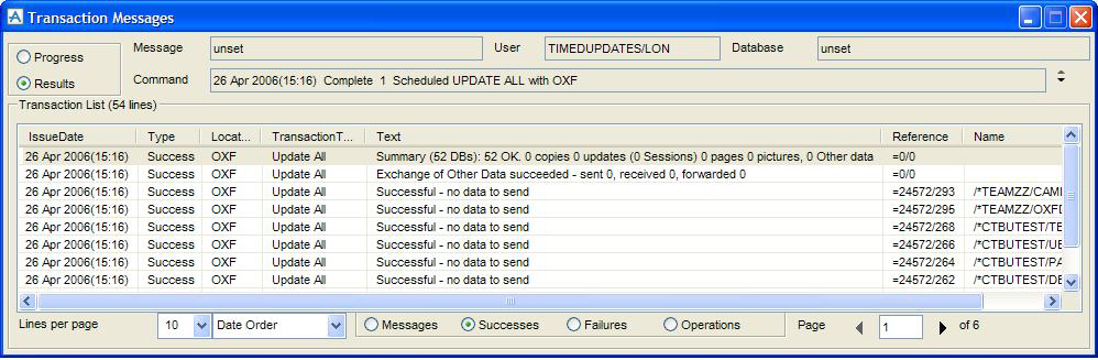

Each successful update also generates a success:
In this case, all successful database updates report ‘no data to send’ since the database was up to date. This is reflected in the summary, which reports the number of successful Copies and Updates.

The success for the Global db is also reported as database =0/0.
