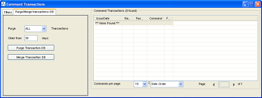

Databases can be merged using the Admin module. From the menu bar select
Utilities>Transactions
to open the Command Transactions form. When the form is visible click the “Purge/Merge transactions DB” tab.
Transactions can be purged based on the results of the transaction and the time the transaction was made.
Use the "Older than" option to specify the number of days; transactions older than this number will be included for purging. The number of days should be in the range of 1 to 365 days.
From the Purge drop-down menu, choose ALL / SUCCESS / FAILURE. Selecting ALL will delete all the transactions which are not in progress and older than the specified time. Selecting SUCCESS or FAILURE purges only Passed or Failed transactions respectively.
Merge Transaction DB will merge the transaction DB of the current location. This will have no effect unless either the database has been purged or commands have been deleted interactively.
The Command transactions form is available in other modules, but will not have the Purge transactions frame.
