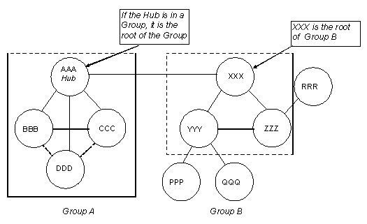

Location groups consist of several locations which all have direct communication links with each other. This means that there will be communication links within a group which do not correspond with parent-child relationships. In the following diagram, the dotted lines show these links.
There is one location in the group which is the Root: this is the first location on the route from the Hub to the group.
