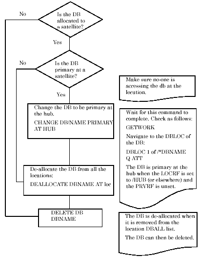

Databases can only be deleted at the Hub. Before deleting a database, the user must change the primary location to the Hub (or elsewhere) and de-allocate the database from all Satellites. The procedure for deleting a database is shown in the following diagram:
