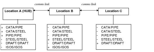

In terms of parent and child locations:
Catalogue creation and Pipework design are carried out at Location A, and so the Catalogue databases and the Pipework Design database must be primary at Location A.
Steelwork design is carried out at Location B, and so the Steelwork Design database must be primary at Location B. Users at Location B need read access to the Steelwork Catalogue, so this must exist at Location B as a secondary database.
Drawing production is carried out at Location C. Users at Location C need to have read access to the Design databases, and write access to the Drawing database, and so the Drawing database must be primary at Location C.
Isometric Production is carried out at Location B. The Pipework Design and Catalogue databases will be available at Location B, and the ISODRAFT database must be primary at Location B. It will not be required at Location C.
The databases need to be allocated, and their primary locations set, as shown in Figure 4:2.: This is the allocation which we want to achieve.. The databases which are primary at a location are marked with a +. This is the convention which is used on the forms in the GUI.
