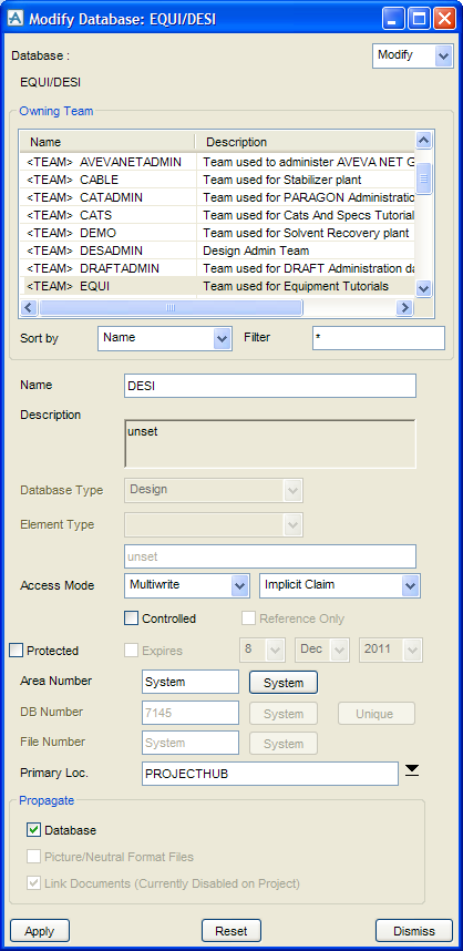

If selecting one of the databases from the
Admin Elements
window and click
Modify
on the
Admin Elements
window, to display the
Modify Database
window.
Note:
The options that are inactive on this window are the attributes of the database that cannot be modified once it has been created.
Select the pull-down option at the right of the
Primary Loc.

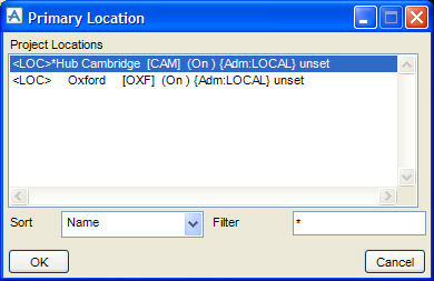

text box, to display the
Primary Location
window.
Select a location, click
OK
, and then
Apply
the
Modify Database
window. The database will now be primary at the Satellite, and secondary at the Hub, as shown by the - sign in the column on the
Admin Elements
window for the Hub.
