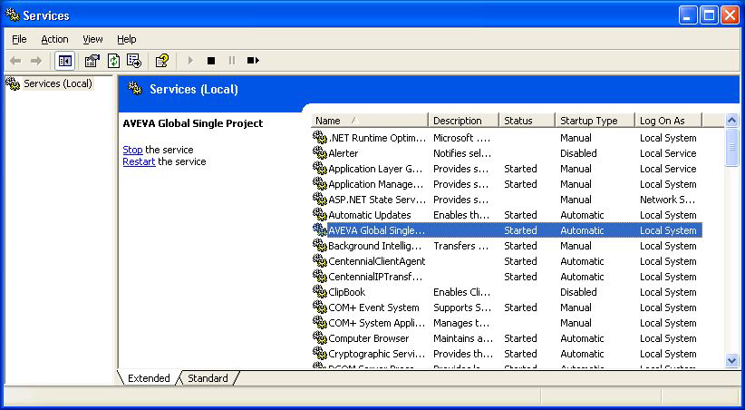

Select Start > Settings > Control Panel > Administrator Tools, and then select Services. To display the Services window, and the Global services you have just set up will be listed.
Select AVEVA Global Multi Project or AVEVA Global Single Project right click and select Start. (Once the service is running, right click and select Stop to stop it.)

Set the Startup Type as follows:
Automatic will start the service on boot-up.
Manual means the use will have to start the service by clicking Start on the Services window.
Disabled means just that.
Allow Service to Interact with Desktop means that a window will be opened for each daemon: this is useful when setting up a project or tracking any communication problems.
