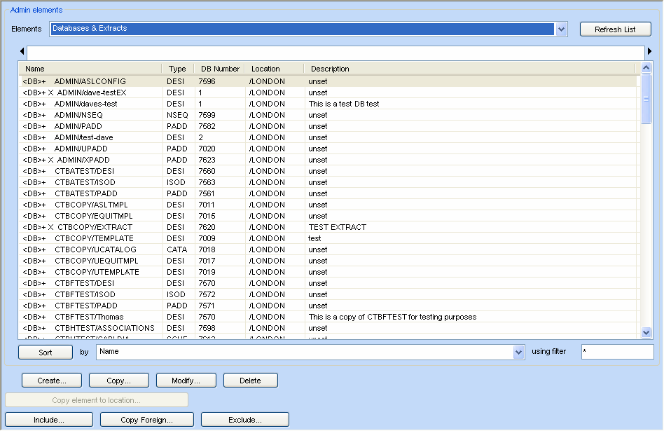

If looking at the Databases version of the Admin Elements window, there is a column containing + signs. The + signs show that the databases are all Primary at the Hub. Secondary databases are marked with a - sign.
