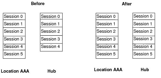

Before the automatic updating can start, Update events must be created between locations. Update events define how often the Global daemons check the databases to see if there have been any updates. The checks are based on the Session Number of the databases. For example, location AAA has a direct on-line link to the Hub. A Design database PIPING/PIPING-A which is primary at location AAA may be at session number 5, and at session number 4 at the Hub. Therefore the database at the hub will be updated with the changes. These changes may then be propagated to other locations that have copies of PIPING/PIPING-A.
