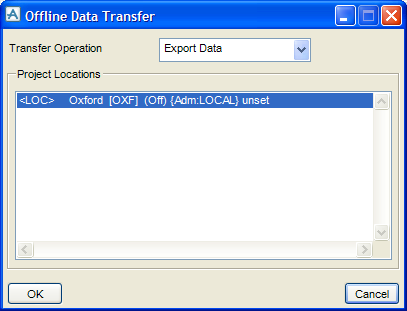

Select Utilities>Offline Transfer, and the Offline Data Transfer form will be displayed.
Set the Transfer Operation gadget to Export Data.
The Project Locations text pane lists the locations available for transfer. At the Hub this is a list of all the off-line locations. At an off-line location this will only show the Hub.
