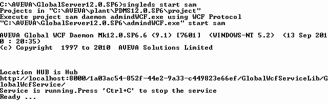

From the Windows Command Line run the singleds.bat file by using the following syntax:
