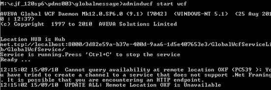

Error description:
To successfully complete a communication the client and the target service must use the same binding
The example below is a netTCP binding client trying to connect to a HTTP binding Service:
Solution:
The user must modify the configuration files so that the client and service communicate using the same binding. Refer to
