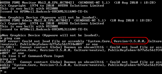

Error description:
The base product monitor console outputs a truncated error as shown below:
Solution:
The error is generated because files are missing in the Operating System that Global has a dependency on.
The highlighted reference number is an indication that Global is attempting to locate files that are part of the .NET Framework 3.5.
Refer to section
Microsoft .NET Framework v4
and download version 3.5 of the Microsoft .NET Framework.
