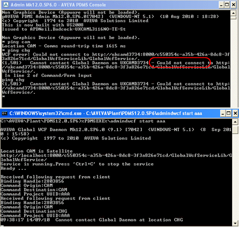

Error description:
A remote Daemon ping failed.
Solution:
Base product gives the same error when the local daemon is down.
Base product will give the same error if running the RPC daemon.
Check for the below highlighted error and make sure that the daemon is running. Refer also to
Remote Daemon Down
