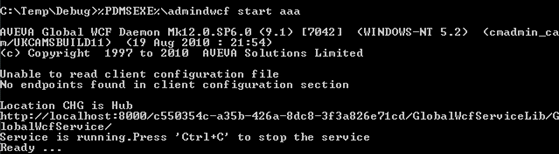

The daemon starts, but reports the error below:
Solution:
The globalWCFClient.config file is missing from the AVEVA_DESIGN_EXE directory.
The globalWCFClient.config file will be installed from installation, check that the file has not been deleted.
