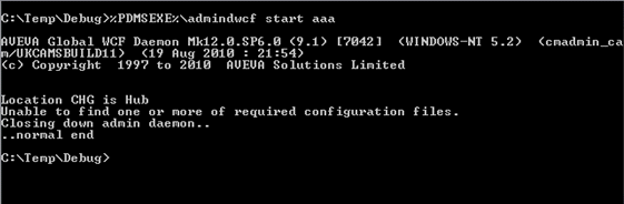

The daemon does not start and reports the error below:
Solution:
The AdmindWCF.exe.config file is missing from the AVEVA_DESIGN_EXE directory.
The AdmindWCF.exe.config file will be installed from installation, check that the file has not been deleted.
