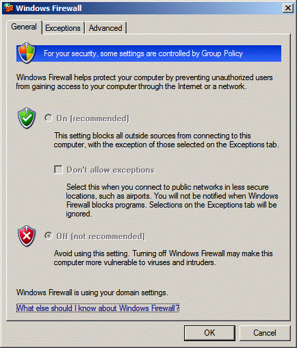

In Windows XP click
Start > Control Panel
Double click to open the
Windows Firewall
Note:
In some cases the Firewall configuration can be can be controlled by a Group Policy on the network Domain Controller. In this case the administrator can configure the firewall settings centrally on the domain controller. The same principles described here will apply.
Click the
Exceptions
tab.

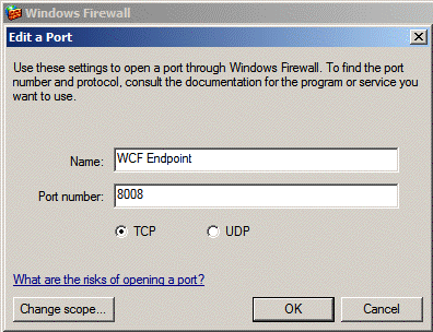

Click
Add Port
Add a descriptive name and then specify the port that has been set up for the
WCF Endpoint

Click
OK
save the changes.
