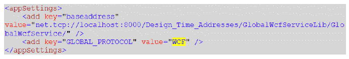

Locate the following
GLOBAL_PROTOCOL
key:
The user can toggle the value between
WCF
or
RPC
Set the value to
WCF
to use WCF as the authentication provider.
add
key
GLOBAL_PROTOCOL
value
WCF
Important:
If the
GLOBAL_PROTOCOL
key is not present in the configuration file then the default of RPC will be used.
