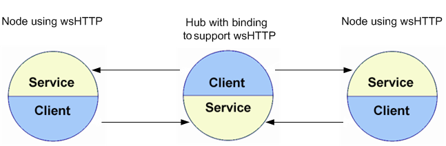

The client and service have their own configuration files that are maintained separately. The AdmindWCF.exe.config file controls configuration of the service and the GlobalWCFClient.config file controls configuration of the client.
The nature of these configuration files is described in detail in section Configure Security. The following describes the theory behind how the administrator should configure settings between computer nodes hosting Global daemons. The binding used must be consistent across all nodes/trust boundaries.
