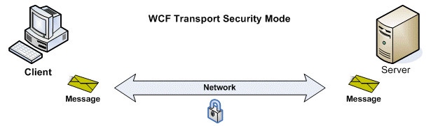

Transport security provides end to end security by securing the actual method of transport that messages take between client and server. Transport security has the following attributes:
Once authenticated, always trusted.
Transport security will not work when crossing more than one trust boundary.
Once authenticated it can subject to threats such as tampering.
Ideal for intranet communications.
Transport security in WCF depends on the
Binding
selected.
