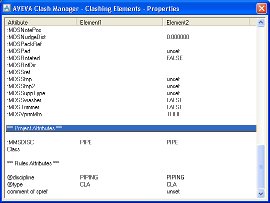

This form provides the administrator with all data necessary to analyse the effects of all attributes that may be involved in the automatic setting of owner discipline and/or status of a pair of clashing elements. The particular elements are selected at the 'Clash Manager - Test Rules' form.
The information is in three-column tabulated records, headed Attribute, Element1 and Element2, which respectively show the name of an attribute, its value for element1 and/or its value for element2.
The upper section of the table displays standard attributes and User-defined attributes.
The next section, headed 'Project Attributes' displays the project-defined fields, such as Discipline, Class and Priority, and the level in the hierarchy where the attribute occurs.
The lower section, headed 'Rules Attributes' displays a consolidated list of the attributes from ALL rules that affect the clashing elements. The rules may not be involved in every instance. The attributes may not exist on the clashing elements themselves, in which case they exist on elements in the hierarchy above them.
