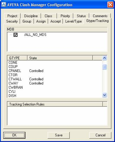

GUI : Clash Manager Configuration Form : Gtype/Tracking
At the top of the tab, a pane called MDB displays a listing of the MDBs defined in Clash Manager. Against each MDB is a checkbox, which is checked by default when the MDB is first defined. As required, the administrator can un-check a checkbox to remove the particular MDB from the Track Changes operation.
In the middle of the tab, a pane displays a listing under headings of GTYPE and State. The listing is used to present a list of available GTYPEs and to enable certain of them to be made Controlled or Uncontrolled. (Only a Controlled GTYPE is the subject of a Track Changes operation.)
