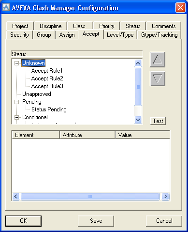

Acceptance Rules may be complicated and time-consuming to develop. A simple method of testing is available to avoid a (very lengthy) Re-Computation option, which may reveal further modifications to the rules are required. The test facilities are available at the 'Clash Manager -Test Rules' form, which is accessed by means of the Test button. The new configuration does not need to be saved prior to using the test facilities.
Upper pane showing a
hierarchy with Status as the primary nodes which, when expanded, display the applicable Acceptance Rules |
A Popup Menu is available (mouse right-click) with options of Edit, Add and Delete. This is used to edit an existing rule name, add a new rule, or remove an existing rule.
