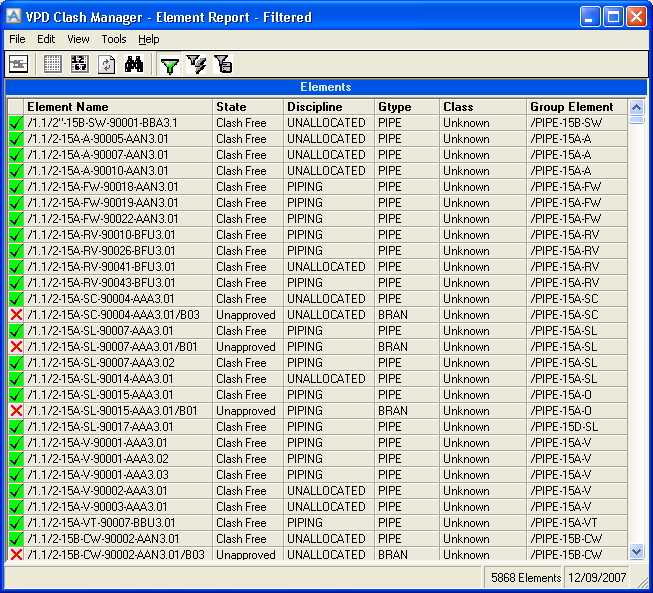

The report is in tabular format; each row being dedicated to an element.
The data in the columns is identified by the column headings, namely,
Element Name
Identification
State
The worst case
state
of Approved, Conditional, Pending, Unapproved or Clash Free. Note that the worst case
state
is displayed rather than the Status
Discipline
Owner discipline
Gtype
Type
Class
Project-defined field, by default known as Class
Group Element
The element in the hierarchy at which Clashes may be aggregated
Note:
In the example above the Purpose Project-defined field is configured as “MMSDESCRIPTION”
The left-hand column shows the status of the group, as follows:
Approved
Unapproved
Pending
Conditional
Clash Free
