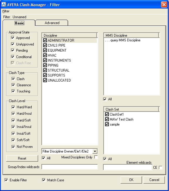

Clash Manager User Guide
GUI : Filter Form
The items on the Basic tab are as follows:
Discipline list with a
checkbox for each
listed discipline.
'Filter' drop-down list
and
All checkbox
below the Discipline
list.
The Filter drop-down list defaults to the report being filtered to the clash owner. The other options enable discipline filtering for either of the clashing elements and the owner. The 'All' checkbox is used to check all disciplines.
Project-define (default
Areacode) list with a
checkbox for each
item.
All checkbox below the
list.
Clash Set list with a
checkbox for each set.
list.
Specific Element wildcards may be separated by a vertical bar, for example,
%42% %43% | %44% %45%
matches any clash where one element name contains "42" or "43" and the other contains "44" or "45"
The items on the Advanced tab are as follows:
Class) list with
checkboxes for 'ALL',
'Unknown', 'Fabricated'
and 'Unclassified'.
Priority) list with
checkbox for each
listed priority.
Status list with
checkbox for each
listed status.
Discipline and Status
checkbox groups with
And/Or radio group.
Comments list with
checkbox for each
listed comment
