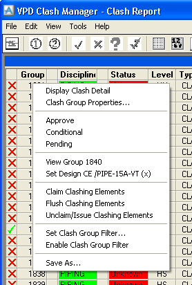

The options available in the popup menu depend on the number of records selected, the report in which they are selected, whether the Clash Details report is displayed alone, and on the security options set by the Administrator. The options, their availability and functions are as follows.

Display Clash Detail
One or more groups in Clash Groups
Displays associated clashes in Clash Details report.
Clash Group Properties
Single clash group in Clash Groups
Leads to the
Clash (Group) Properties Form
Clash Properties
Single clash in Clash Detail
Leads to Clash Properties form.
Edit Clash Groups
Multiple groups in either
Leads to the
Edit Clash Groups Form
Assign Owner Discipline (Disc Name)
Single group in Clash Groups
Sets discipline required to resolve clash.
Approve
One or more in either
Sets status to Approved.
Conditional
Sets status to Conditional.
Pending
Sets status to Pending.
Unapprove
Sets status to Unapproved.
View Group(s) (number)
Displays the selected group(s) at the 3D display.
View Clash(es) (number)
One or more clashes in Clash Detail
Displays the selected clash(es) at the 3D display.
Set Design CE (first element name)
Sets the selected item to be the Current Element.
Set Design CE (second element name)
Claim Clashing Elements
Extracts the selected item in the hierarchy and brings it to the user's workspace.
Flush Clashing Elements
Saves the changes to the master model.
Unclaim/Issue Clashing Elements
Issues the changes to the master model.
Set Clash Group Filter
Leads to the Clash Manager -
Filter Form
Set Clash Detail Filter
One or more clashes in Clash Detail when displayed alone
Filter Form
Enable Clash Group Filter
Applies the filter criteria to the data displayed.
Enable Clash Detail Filter
Save As
Saves the Active pane.
Note:
Some of the options above will not be available if the User has insufficient access rights, as set by the Administrator. Typically this may include Assign Owner Discipline, or Approve.
