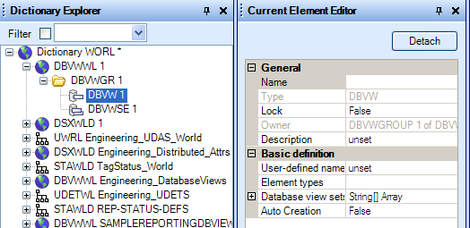

Database Views : Create Administrative Elements : Create a Database View
Refer to Database Views for further information.

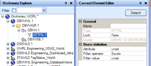

Rows are present in the resulting Database View table for each element that has a particular element type (ELEL) and meets any defined criteria (ATTFILTER and EXPFILTER). The Attribute Filter element is used to define matching criteria.

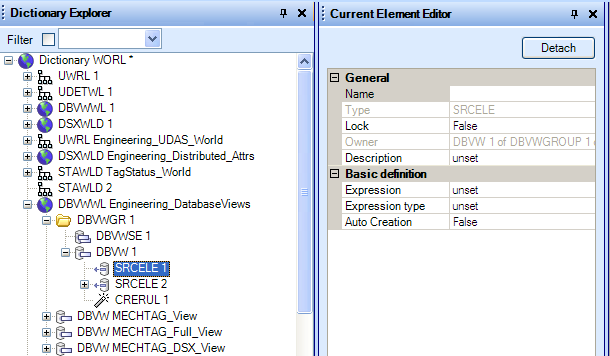

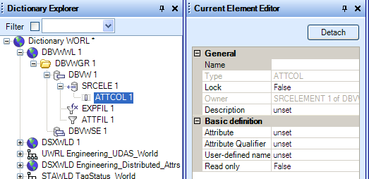

The ATTCOLUMN element defines the attribute columns displayed in the database view, the columns operate on the SRCELEMENT that contains them.
Make sure that the correct SRCELEMENT in the dictionary hierarchy is selected, right click and from the displayed menu select Create then select ATTCOLUMN: Attribute column from the displayed list.

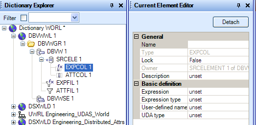

A EXPCOLUMN element defines a column in the database view is based on an expression result, by default these columns are read only.

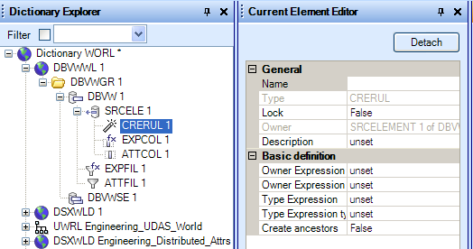

A CRERULES element defines the rules for the creation of the context element. If owned by a DBVW element, the rules define row element creation, if owned by a SCRELEMENT the rules define column element creation.

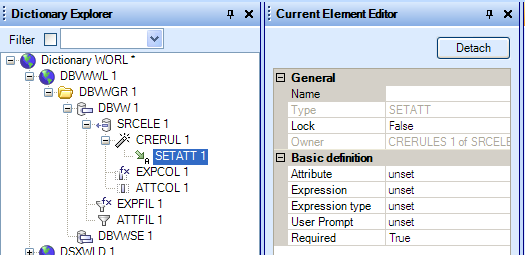

A SETATTRIBUTE element defines the setting specified attribute. Make sure that the correct CRERULES element in the Dictionary hierarchy is selected, right click and from the displayed menu select Create then select SETATTRIBUTE : Set attribute rule from the displayed list.

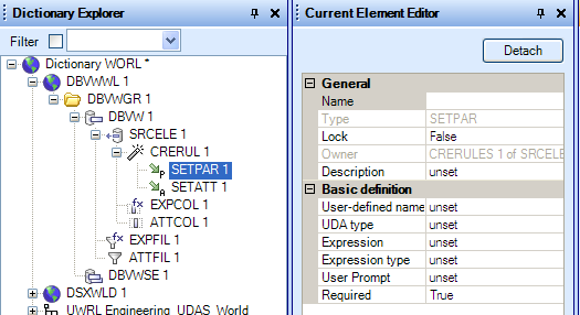

A SETPARAMETER element defines a parameter that can be used with create expressions. The parameter value can be defined with the use of an expression, if unset, the user is prompted for input.
Make sure that the correct CRERULES element in the dictionary hierarchy is selected, right click and from the displayed menu select Create then select SETPARAMETER : Set Parameter from the displayed list.
