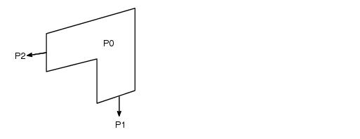

2.
To use this symbol, the p-points must be arranged as shown in the following diagram:

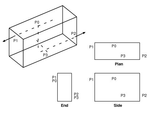

3.
Note:
That the horizontal offset may be zero; i.e. P0, P1, P2 and P3 may be coplanar.

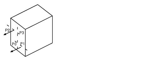

4.
Note:
That the horizontal offset may be zero; i.e. P0 and P1 (and similarly P2 and P3) may be coincident.
