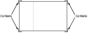

Figure 2:1.
The location of cutting marks

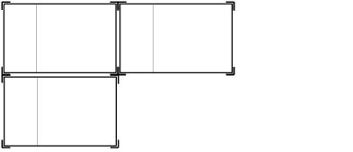

Figure 2:2.
Cutting marks on multiple plots
