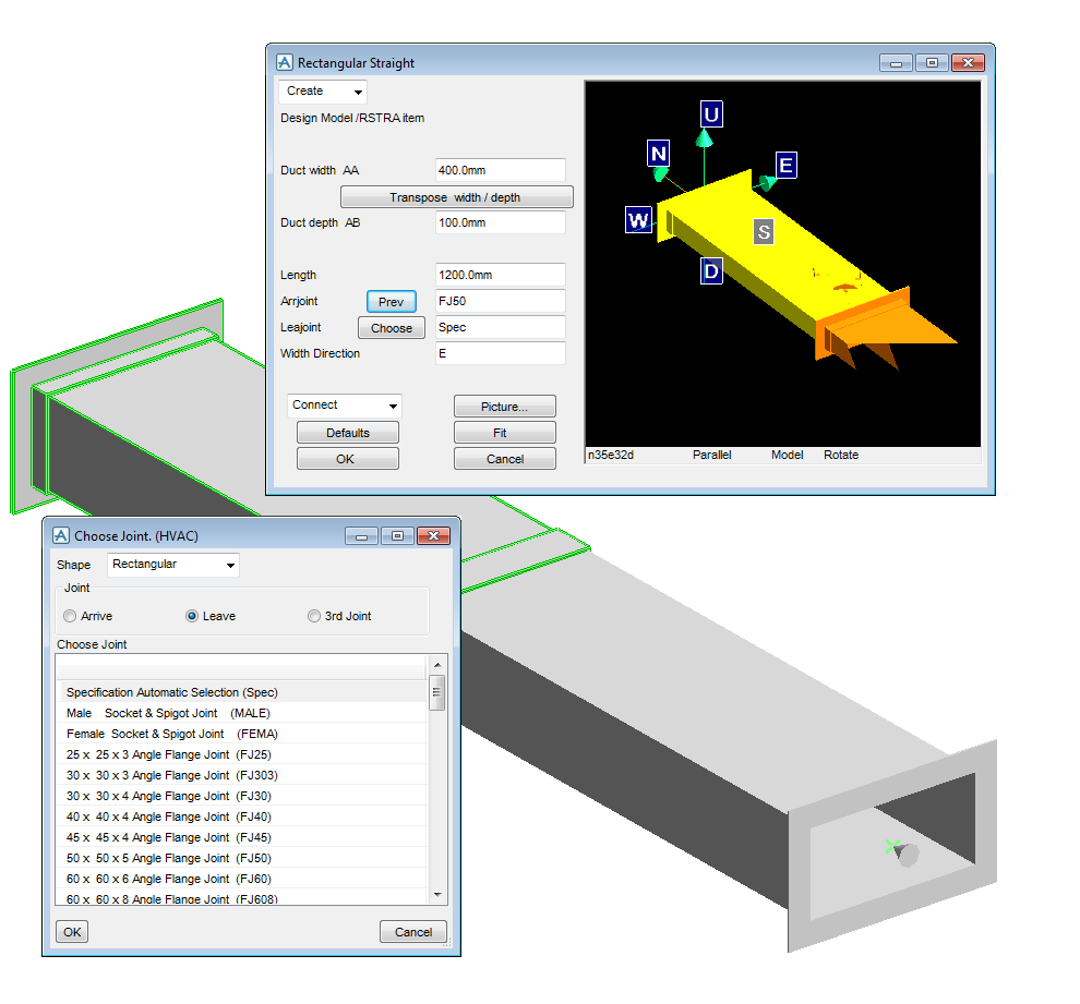

Set the Joint to FEMA on the detailing spec joints
At creation time the application then selects a male after each female.

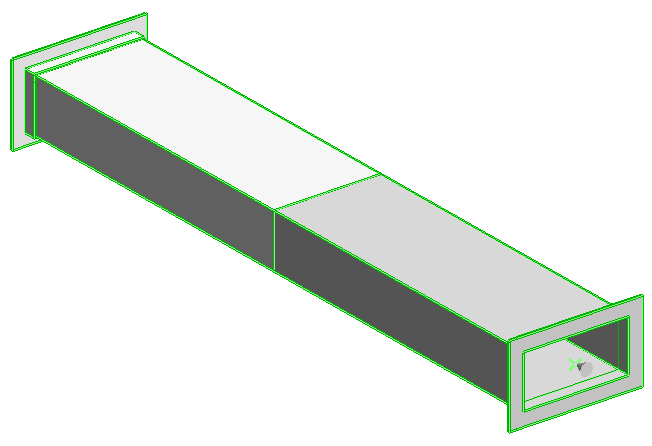

The above does not show the collar thickness. (Default)
So without the green line outline the joint just looks like a butt joint

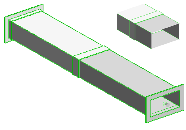

It is possible to show a collar by setting the
/CADCHVACCATA-Joints-RECT/FEMA/HVJA PPRO ( 100 )
/CADCHVACCATA-Joints-RECT/FEMA/HVJB PPRO ( 3 )
The above selection was from the Choose Joint which you can see gives you Male/Female Socket and Spigot description.

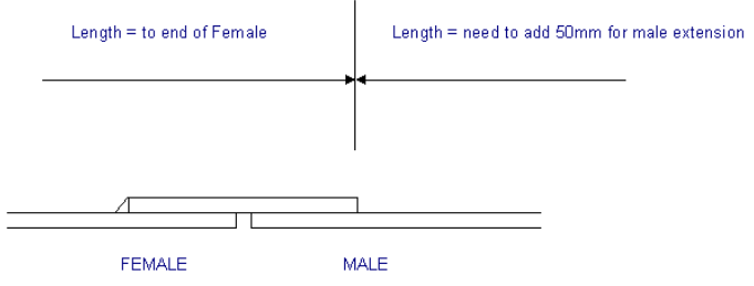

Note it must be clear to the user how to interpret the length of each piece because Length= PA to PL but you want 50mm male insert extra.
