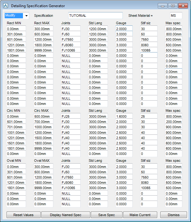

A Detail Specification is a table of rules to define duct ranges with different Joints, standard length, material thickness or stiffening.
This information for HVAC is currently not stored in the specification database but in system files. The default directory for this is %AVEVA_DESIGN_DFLTS%/hvacadvspecs, however, this can be changed by the Administrator in the control file, xmaincontrol, mentioned earlier.

These lines refer to files that have been saved into the same directory named: example
%AVEVA_DESIGN_DFLTS%/hvacadvspecs/tutorial and xtutorial
When defining these files Administrators must make sure that they have r/w access, whereas the users will never have write access to these files.
