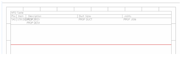

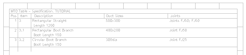

The above figures show the MTO/Material Take-off tables first on the backing sheet and then on the finished drawing. On this type of table the 'cells' data need to be attributes of the HVAC Spool elements. E.g. DTXR and DTXS attributes as used in the Description and Detail columns.
The user can also user PROP attributes such as PROP RTEX, PROP DUCT, PROP DETA etc as shown below
