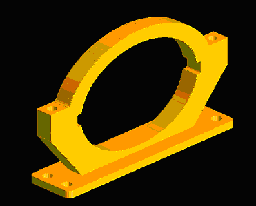

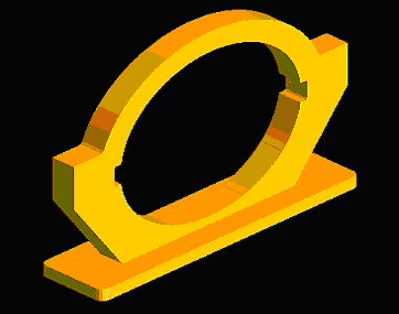

The Wrapper option should be used only when the user is sure that most or all solid parts are inside other parts and can therefore be removed without affecting the appearance of the model. If the Wrapper option is used when this is not the case, then the resultant model may be too difficult to manipulate, due to the fact that Wrapping prevents any primitive recognition, increasing the amount of data that has to be transferred.
