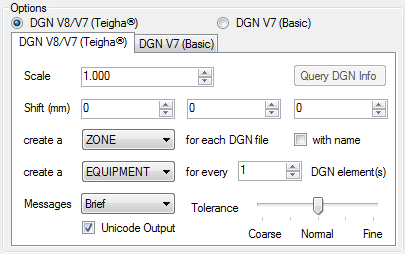

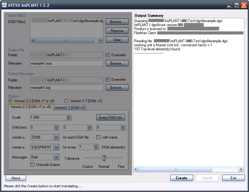

To run Import-DGN, on the Equipment tab, in the
Import group, click
DGN to display the window.
Import-DGN (Basic) cannot translate some MicroStation Feature Solids. The MicroStation Solid Utilities: Convert to Solid tool can be used to convert these to Smart Solids, and follow the instructions above.
Clicking Clear removes all files from the list.
If the Overwrite box is checked, the program allows the user to overwrite the output file without warning.
Scale allows the user to scale the imported geometry. A number larger than 1 makes the imported geometry bigger, and a number smaller than one makes the imported geometry smaller. A model can be corrected if the units in the DGN file are wrong, missing, or misinterpreted.
Shift (mm) allows the user to shift the whole model in E, N and/or U by the given numbers of millimetres. The user can position a model more conveniently, or simulate the MicroStation global origin.
The user can choose the number of messages to be written to the Output Summary and the Message file. The options available are Brief,
Full or
Debug. Debug is very verbose, and is primarily intended to help developers to investigate any issues with the translations of particular files.
The Unicode Output check box should normally be selected. Do not use this option if the macro is used in with older versions of PDMS.
Query DGN Info opens each DGN file listed, and writes some summary information about each into the Output Summary.

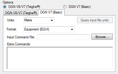

The user must choose a suitable set of units. Query input file units opens the first dgn file listed, and display the units information found in it. The user must then select a matching value from the Units drop-down. The possible choices are
mm,
cm,
Metre,
Inch,
Foot,
Yard.
The user can enter or Browse for a file ImPlant - I1.exe commands, for example to set up Steel recognition.
Note:

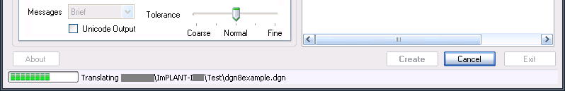

Cancel is not active in an Import-DGN (Basic facilities) translation.

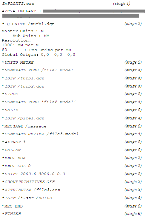

To display the ISFF unit information from a file, use the Q UNITS command. For example, if the file being worked on is called
example.dgn type:
In this case, the MicroStation user has chosen to use metres as the master unit, millimetres as the
sub-unit, and has one eightieth of a millimetre as the
position unit.

INCH the user should use that keyword. In this case type:
Text in italic indicates what the user is typing.
Open a AVEVA E3D™ MODEL macro file called file1.mac which holds the AVEVA E3D™ commands for importing 3D data taken from the DGN files specified by the next ISFF commands. Every
GENERATE command closes down any previous opened files.
Read the file turb1.dgn for 3D data and generate the commands for import to AVEVA E3D™ MODEL. The primitives generated are under the ZONE element called /
turb1.dgn as no zone name was specified.
The STRUC command sets the mode so that the ISFF command generates the hierarchy STRUC/SUBST/Geometric primitives (BOX). The
EQUIP command sets the mode so that the ISFF command generates the hierarchy ZONE/EQUIPMENT/Geometric primitives (BOX). In EQUIPMENT mode, the primitives are packed into the same EQUI until a MicroStation CELL entity is encountered. Then a new EQUI is generated. If GROUP ON is set in addition to EQUIPMENT mode then a new EQUI is generated for each micro station primitive.
The VOLM command does exactly the same as the
EQUIP command but replaces all EQUIPMENT elements with VOLUME elements.
The ATTRIBUTES filename command opens a new attributes file and switches attribute processing on. Opening an attributes file closes any attributes file that is already open.
ATTRIBUTES END closes the attributes file. The output of attributes can be toggled on and off.
Note:
Import-DGN maintains cell ownership and Review segments within a cell segment inherit the attributes of the cell segment. In other words, the segments within a cell do not have attribute entries within the AVEVA Attributes file, only significant segments do.
Read all files with extension .str which have been generated by MicroStation and append the primitive records to the Review file
file3.model. Standard windows wild-card characters may be used.
After this command has been given, primitives with colour 0 are not exported. To include primitives with colour 0 again, the commands INCLUDE ALL or
INCLUDE COL 0 can be used. Note that sometimes MicroStation users use colour 0 to create a face that they subsequently use to create a projected surface, or surface of revolution object with a different colour. In this case there is a clash of colour between the construction face colour (that is 0) and the object's colour as they occur in the same place. To avoid this clash of colours, in Review export only, exclude colour 0 from the model.
Most of the EXCLUDE/INCLUDE options are self-explanatory. However there are some options that describe MicroStation type of primitives/records and others describe 3D type of models as generated by ImPlant - I.exe.
The MESSAGE command specifies an output file where all user commands and output messages can be stored. The
MES END command closes the file.

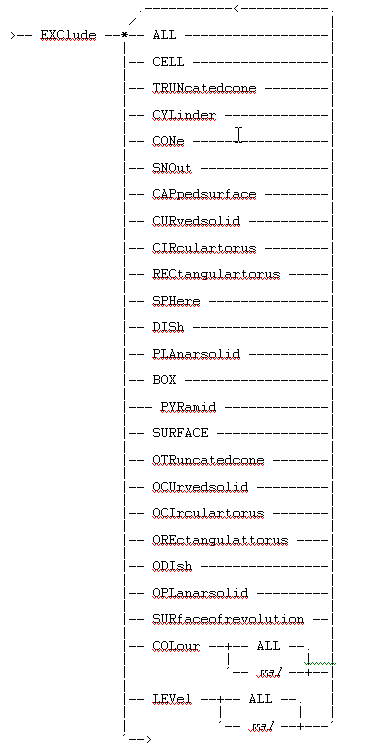

The EXCLUDE command can be used to control which primitives are translated. The user can exclude primitives by type, by colour or by level. Refer to the
INCLUDE command for further information.
The EXCLUDE LEVEL command has an extended form not shown in the picture to exclude several levels in one command; for example:

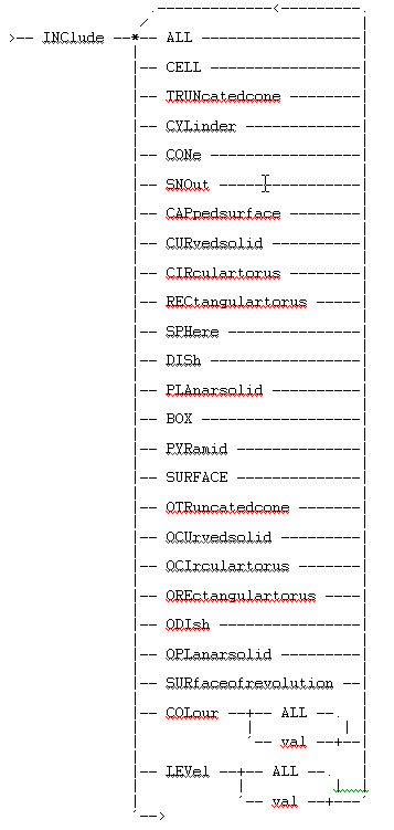

The INCLUDE command is the opposite of
EXCLUDE; that is, excluded options are included for export again. Refer to the notes on
EXCLUDE and the example in
Example ImPlant - I.exe Session, for further information on primitive types.
