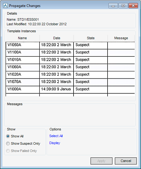

On the Design Templates tab, in the Tools group, click Propagate Changes to display the Propagate Changes window.

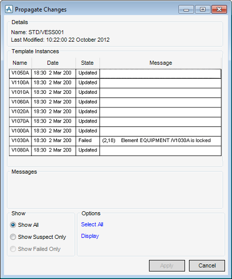

The Template Instances part of Propagate Changes window displays a list of design instances for the currently selected Design Template and the current State of each design instance.
The Messages part of the Propagate Changes window displays relevant messages for the selected design instance during the update process.
When design instances have been selected, click Update to propagate changes to the selected elements.
Click OK to propagate changes to the selected design instances or Dismiss to discard any inputs.
