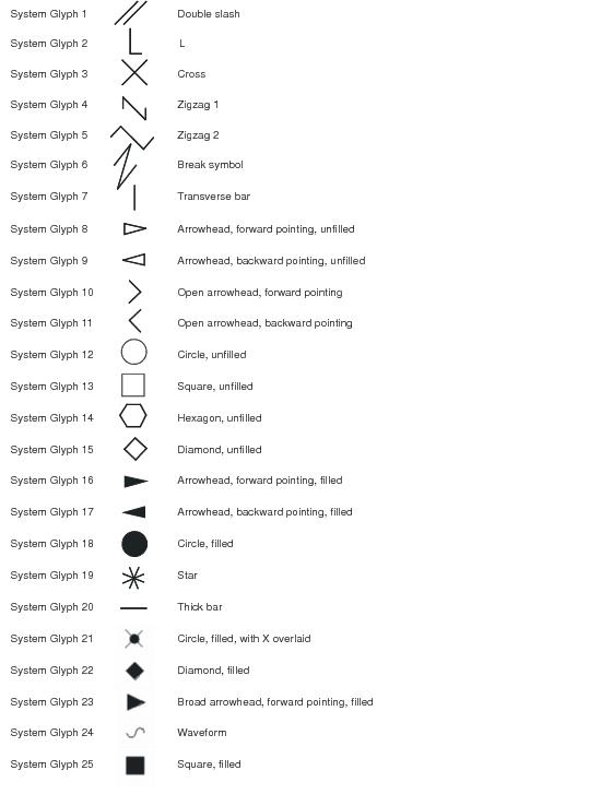

Colours and Styles : Line Styles : Glyphs
Figure 8:3.
User-defined Glyphs are defined in the database by GLYPH elements which are members of a Glyph Table (GLYTB) element. GLYPHs have the following attributes:
