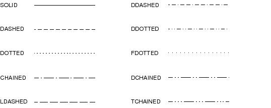

A system-defined line style is specified by combining one of ten basic line patterns (refer to
Figure 8:1.: Basic User-Defined Line Patterns
for further information) with one of three line widths.
Figure 8:1.

Thus for example:
NLSTYLE LDASHED
gives a long-dashed line of THIN width
FFSTYLE SOLID
gives a solid line of THIN width
OBSTYLE DOTTEDMedium
gives a dotted line of MEDIUM width
PLSTYLE DDOTTEDMedium
gives a double-dotted line of MEDIUM width
CLSTYLE CHAINEDThick
gives a chained line of THICK width
BFSTYLE DASHEDThick
gives a dashed line of THICK width

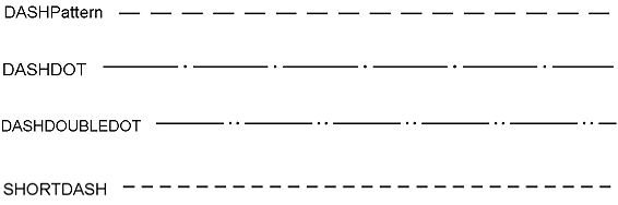

For historical reasons an alternative set of line patterns is provided (refer to
Figure 8:2.: Alternative Pre-defined Line Patterns
for further information).
Figure 8:2.
These alternative line-patterns can be combined with widths named WIDE and XWIDE, thus for example:
NLSTYLE DASHPattern
gives an alternative dashed pattern of THIN width
OBSTYLE SHORTDASHWide
gives a short-dashed line of MEDIUM width
BFSTYLE DASHDOTXWide
gives a dash-dotted line of THICK width
FFSTYLE SOLIDXWIDE
gives a solid line of THICK width
Note that for consistency WIDE and XWIDE can be also used with the basic pattern SOLID.
