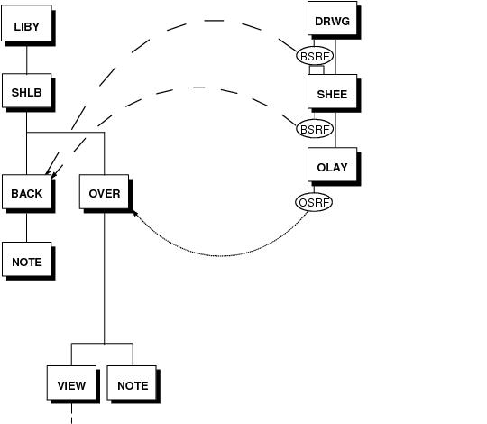

The SHLB (Sheet Library) exists as a member of a LIBY and is used as an administrative element to group together BACK (Backing Sheet template) and OVER (Overlay Sheet template elements.
BACKs and OVERs are referred to by the relevant drawing Sheet’s BSRF and the relevant Overlay’s OSRF attributes (respectively). (BSRF may also be set at Drawing level.) The BACK/OVER to be used may be specified by using commands such as:
