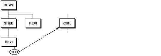

(REVI) element enables you to store drawing revision data. A REVI may be a member of a Drawing element or of a Sheet element. Refer to
Figure 9:3.: Revision Element
for further information.
Figure 9:3.
Revision Element
