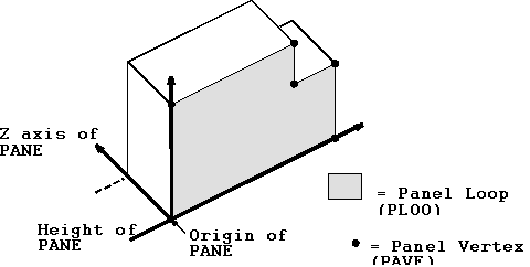

Description:
The PANEL element is used to represent sheet materials (walls, floors, decking, and so on.) used to clad the structure. It is defined by sweeping a profile representing the panel's shape (the Panel Loop. PLOOP) through a given distance (equivalent to the panel thickness) for more information, refer to the following figure.
