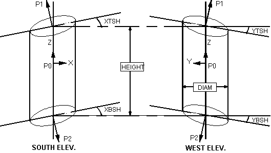

Area Slope Bottom Cylinder Element (ASLCYLINDER)
Area Element
Attributes:
Name
Name of the element
Position
Position
Orientation
Orientation
Level
Drawing level
Obstruction
Obstruction level
Diameter
Diameter
Height
Height
Xtshear
X top shear: inclination of top face to local X axis
Ytshear
Y top shear: inclination of top face to local Y axis
Xbshear
X bottom shear: inclination of bottom face to local X axis
Ybshear
Y bottom shear: inclination of bottom face to local Y axis
The origin of the Area Slope-bottom Cylinder is at the mid-point of the axis (mid-way between P1 and P2) and the default orientation is with the axis on the Z-axis.
