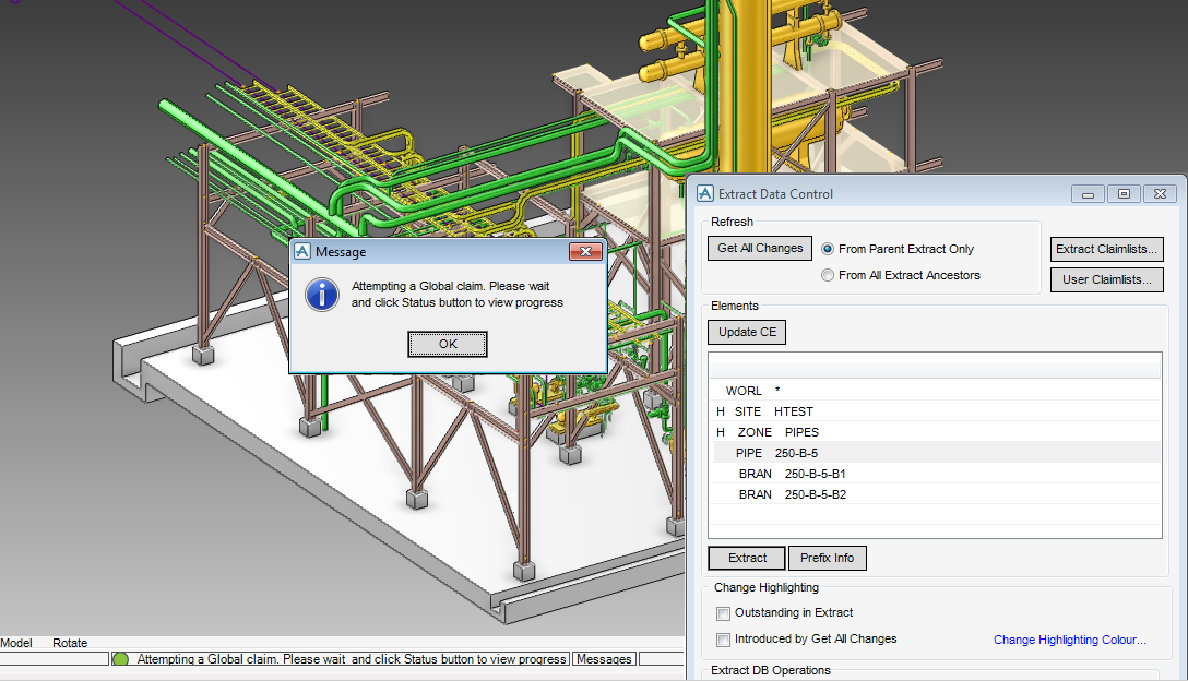

For example the user uses the
Extract Data Control
window to claim a pipe, which generates an error and is reported in the
Message
window.

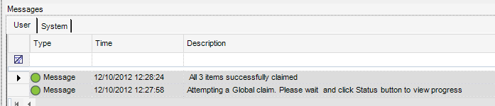

The command is then sent to the Global daemon and will complete in a short while. In the meantime the user can do other tasks using AVEVA E3D™. Once the Global daemon has completed the claim (success or failure), it is reported in the
Message
window:
Expanding the message box displays previous commands:
If the claim command succeeds, but one or more items cannot be claimed (it may be claimed by a user in the Master), then the message reports how many items failed:
