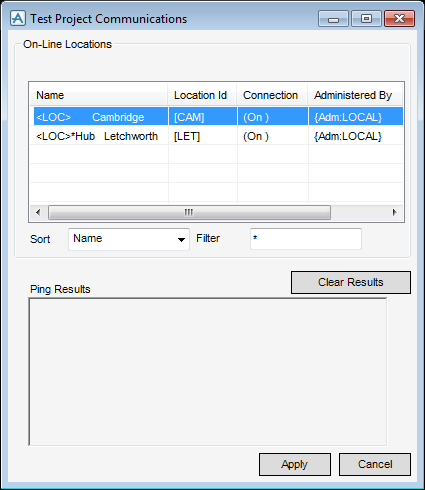

On the Manage tab, in the Extracts group, click Communications to display the Test Project Communications window.
The Test Project Communications window will display a message giving the time taken to contact the remote location if successful, or informing the user that there is a communication failure, in which case, one or both of the daemons must be re-started.
Ping Results will display communications messages once the user clicks Apply. The user can click Clear Results to remove all messages on the Ping Results list.
