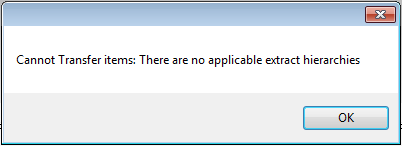

The Transfer functionality is only available if there is a suitable database in the MDB (must be either the master or extract in extract hierarchies which only contains a single child extract). If no such database exists an error window is displayed.

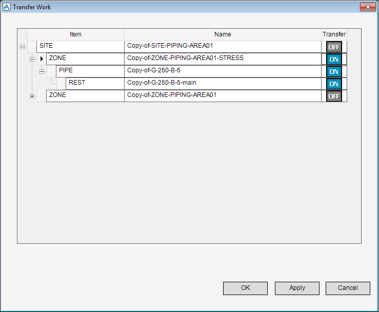

The Transfer Work window does not query the service to see what has already been scheduled. Feedback on Apply is only provided. If the Transfer Work window is closed (when the user clicks OK) and re-opened, the Transfer items are generated from the current state of the Project databases without reference to already scheduled items.
The Transfer Work window displays all items in the Master or Extract that potentially can be transferred to the remote location. In the Transfer column select to toggle ON/OFF of the item that needs to be transferred, click Apply then OK (the OK button is temporarily disabled when the user clicks Apply, as the selected items are being transferred). Selected items are sent to the scheduler to be transferred when the next schedule runs according to schedules defined by the Project Administrator.
Note:
If the user closes and opens the Transfer Work window the previously selected items are displayed OFF.
