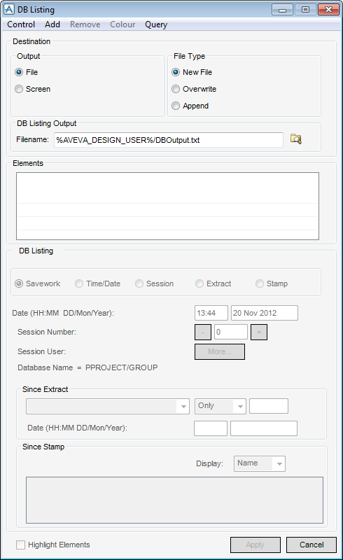

Data Check : DB Listing
The DB Listing window allows the user to query and output aspects of the database for example to report changes since a certain date.
On the Manage tab, in the History group, click DB Listing to display the DB Listing window.
Clears the Command Output window used when Destination is set to Screen.
Displays an Output Options window allowing control over specific information to be output in a query.
The menu options under Add and Remove are used to populate the Elements list.
The Remove option is only active when there are elements in the Elements list.
The Remove option has the following items which are not present in the Add menu:
Displays a Colour Selection window. When a colour is picked, the contents of the Elements list is highlighted in that colour, in all the graphical views. Only elements already in the Drawlist is highlighted; elements are not automatically added to the Drawlist.
The option is Changes or Differences according to the mode. It is not available at all in DB Listing mode and displays a Colour Selection window.
When the user clicks Apply, the colour picked is used to highlight any elements that have changed.
Removes the highlight from the CE only, the Elements in the list or All elements in the graphical views.
A Query is always output to the screen. If the Destination is set to File then output is made to the specified file as well as screen.
CE and Elements
The options under CE output information about the current element, and the options under Elements output information about all the elements in the Elements list on the window.
Both Query > CE and Query > Elements have the following sub options:
Note:
The Query operation can be a time consuming operation if the CE is a DB world element or a large site, or other top-level element, and so the user is prompted with a message to confirm this operation.
Similar to the Last Modified Query, but gives the information for every session in which the element has been created or modified. The user needs to confirm the query for top-level elements.
The user can send the output of queries to a File or Screen. If File is selected, enter a valid path and filename.
If Screen has been selected, the result is the output to a standard Command Window when Apply is clicked.
Select New File to create a new file to output the result to. Select Overwrite or Append if the file exists.
Browse displays a file browser allowing a previously created output file to be used as the destination.
The active field in the Changes Since pane depends on the mode (Changes, Listing or Difference). None of the controls are active in DB Listing mode. In DB Changes and DB Differences modes, the following options can be selected:
Reports on the changes since the Stamp selected from the Since Stamp list at the bottom of the window.
Remember that each DB has its own sessions. The current DB is displayed by Database Name at the bottom of the frame. Refer to Changes Since Stamp for further information.
Note:
Time Date and Session are related, changing one affects the other settings, and also display the correct Session User.
Click
More to open a window that displays the Database Name, Reason for session (such as a Save Work), the Session No (the session number) and any Comments associated with the Session.
The Highlight Changes option is only active when the window is in DB Changes or DB Differences mode with a DESIGN database selected. If switched on, the changed elements is highlighted in all the 3D graphics views in the colour specified by Colour > Changes. The Highlight Changes option is useful after a Get Work to view the changes that other users have made.
Apply is only active when there are elements in the Elements list.
Cancel exits the window and clears the Elements list.
